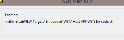

I'm currently developing with the NI WSN modules 3226 and the programmable gateway 9792.
I need to programmatically configure the wireless network i.e. add and and remove measurement nodes, change acquisition rate,...
I've found an example that seems to do exactly what I need:http://www.ni.com/example/31480/en/
but I miss several vi's from the "Host API" folder:
where can I download these vi's?

FYI, the missing Vis were part of the
LabVIEW 2013 Wireless Sensor Network (WSN) Module Pioneer
which can be downloaded from: https://www.ni.com/en/support/downloads/drivers/download.ni-wsn.html
