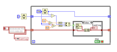

I was thinking more like this...
This will capture all loop variations that are more than 10% of your target time. (might want to make the tolerance a bit tighter)
