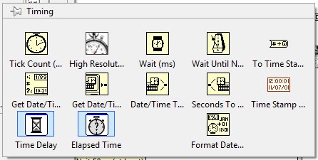

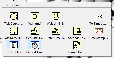

It looks like NI has recognised the need of promotion the High Resolution Relative Seconds.vi to the Timing palette:
in LV2013SP1 the Timing palette looks like that:
and in LV2014 it looks like that:
So now we can measure the time in interval less that 1ms. Great!
High Resolution Relative Seconds–Returns the value of the timer. This VI is similar to the Tick Count (ms) function, except that this VI provides a time stamp with a much higher resolution. You can use this VI to benchmark code with high precision.
