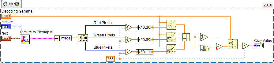

Perhaps you want something like this:

Left and top should be the indices, right-left and bottom-top the lengths...
You don't need the Array Subset if you get the subset from the pixmap (as suggested)...
