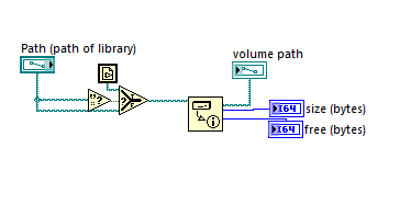

Here's what I use for disk space:
Note that by default, this gives you the free space on the volume that the VI containing this code is on.
Pass in a different path if you want the space on a different volume.
GET VOLUME INFO.vi is on the ADVANCED FILE FUNCTIONS palette.
