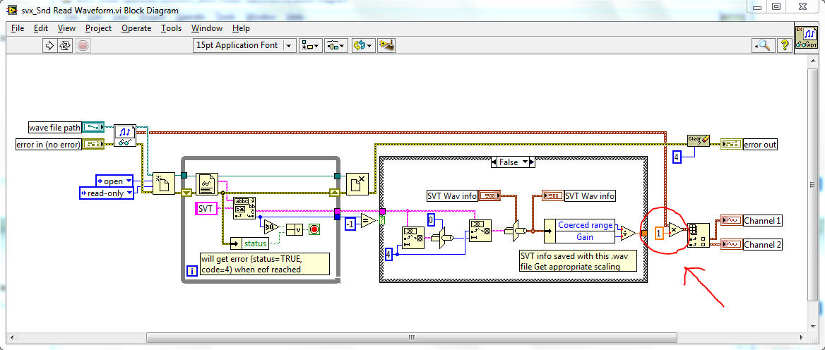

Message contains an image
Does any one know if that problem was solved?
I was analizing the svx_Snd Read Waveform.vi from 2011 version as I will need to use it in my application and found that no scaling is applied to the data, see attached image. Is that vehaviour normal or is that problem was not solved?
