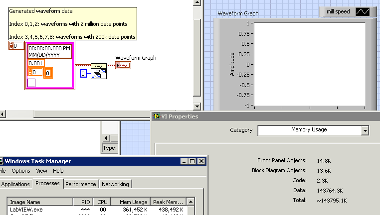

I can't post my main code, but I created a tiny VI which shows my memory issue pretty well. Here are some pictures:

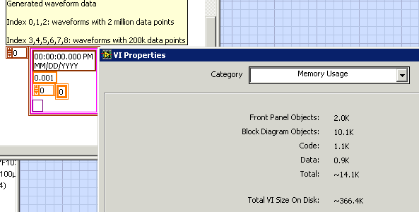

Sample data before doing anything. It only takes up 366kB of space on the harddrive (which seems really small...). Right now the VI contains nothing but this array of waveforms. The first three waveforms contain 2 million data points, and the next six contain 200k data points, to accuratly mimic the data I'm having trouble with:

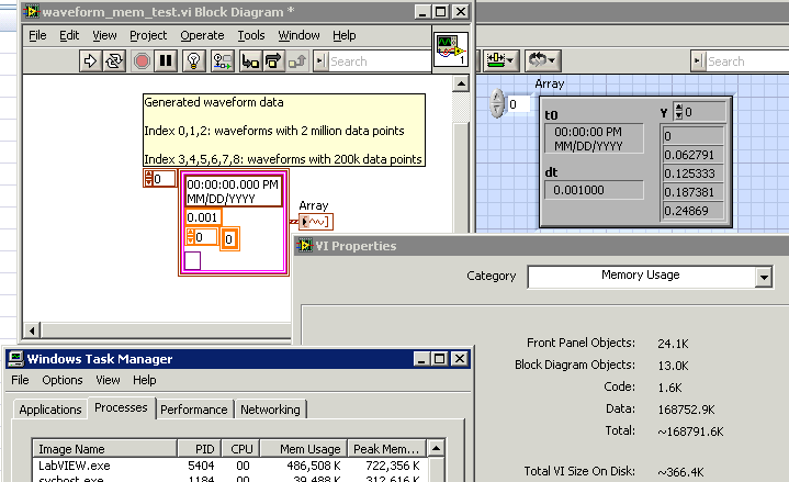

When I try to display the waveform with a front panel indicator LabVIEW takes 722MB of ram and the VI uses about 168MB of ram:
I want to display these as a graph though. So if I index the array and display one graph, the VI uses just slightly less memory than it did when it was displaying the entire waveform array indicator. The peak memory is much lower though. I guess because it only looks at the first waveform in the array rather than all of them?

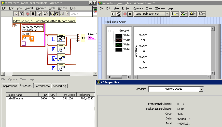

What I really want to do is display four signals on a mixed signal graph. When I try do do that, LabVIEW uses about 800MB of ram and the VI uses about 430MB of ram:
Just displaying the data on the front panel uses ~700+ MB of ram. When I start to pass the data to subVIs to do data analysis, the amount of memory used can shoot up to 1.5GB, at which point my computer runs out of memory and LabVIEW stops working..
