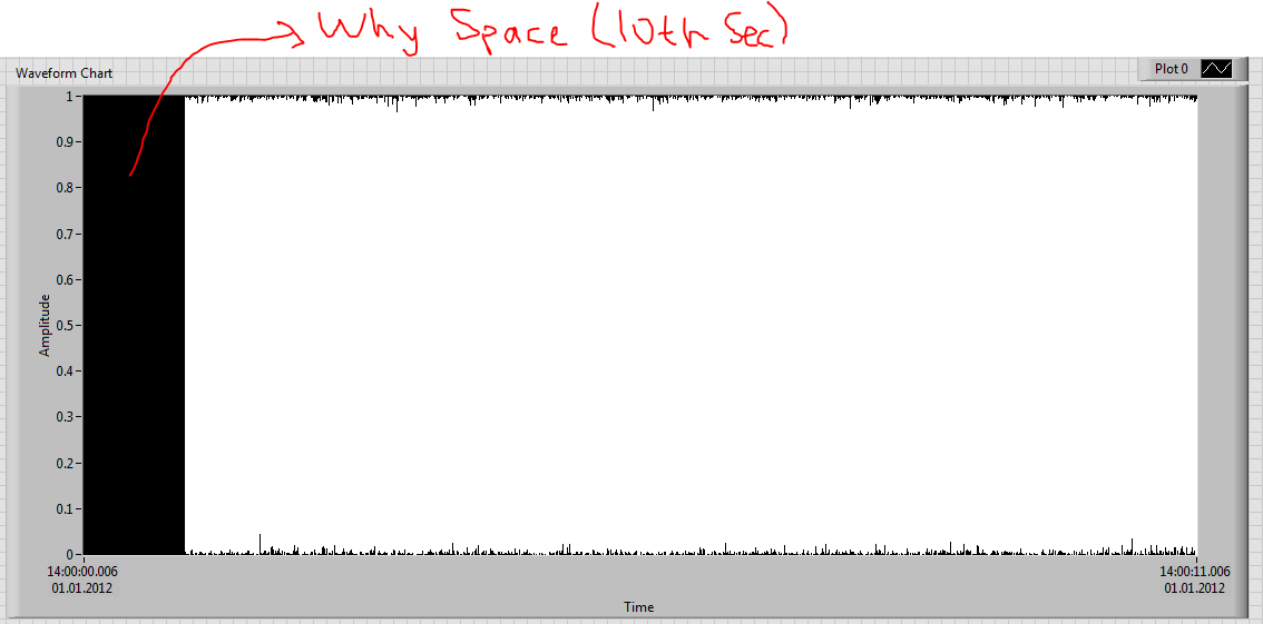

I have a interesting problem.I simulated to 16Khz signal and drawing with waveform chart.Waveform's chart history lenght 10.
problem occurs space in 10th second.Simulate Cod is below.How to resolve this problem?

What exactly is the problem you are seeing?
Mike...
Certified LabVIEW Architect
LabVIEW Champion
(4,739 Views)
problem is create space in waveform chart in 10th seconds...you can see when run simulate program.
Thanks for answer...
(4,732 Views)
I see that issue only happens when you set the Auto scale x when you remove that it doesn't seems to be happening.
(4,728 Views)
Thanks for answer
but not resolve the problem when  Close auto scale x .
(4,713 Views)
Try starting the group number at 0 not 1. The first time through you don't want to add any time offset to t0.
