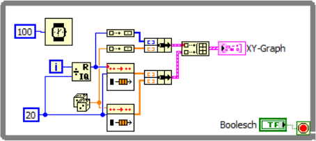

Hi edu,
you can have the same effect with a XY graph - once you provide the correct data in the X and Y arrays:
Set the first plot to show points and the 2nd one to show just the line…
(You only need to handle the "backfold" line. Well, you need to do atleast some part of your job on your own… 🙂 )

"...but I was told today that the graph has to be XY..."
Why does it have to be XY? Who told you, and did they explain? If they told you that, they can probably tell you how to do it too!
But anyway, if you look back to page 2 of this thread I posted an example vi using an XY graph already. It updated like a chart rather than a sweep, but I said how to update like a sweep instead.

For a chart mode, using a buffer that adds points to the end of an array and deleting the oldest from the front is correct.
For a sweep mode, maintain an array, but use replace array subset to put elements into the array.  Every iteration update the index value where that point is placed and roll around when it reaches the end.

Hi, I finally succeded with the XY graph, now I am just working on speed.. Thanks to all of you!
