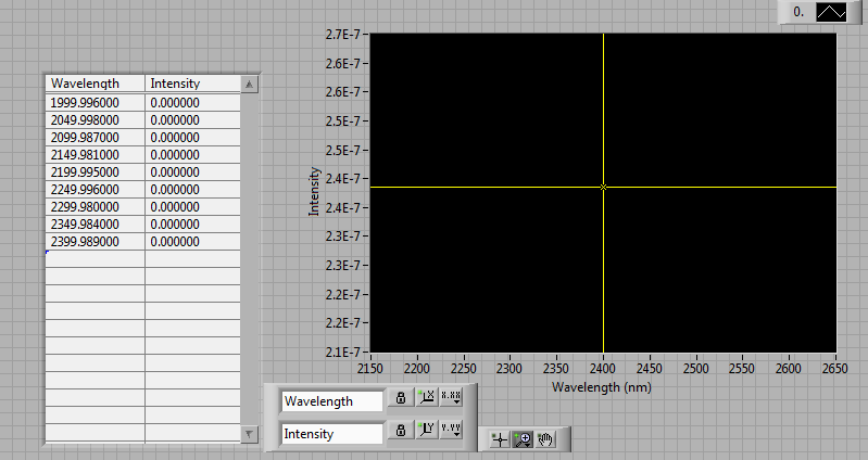

Waveform graph is plotting but no line is shown

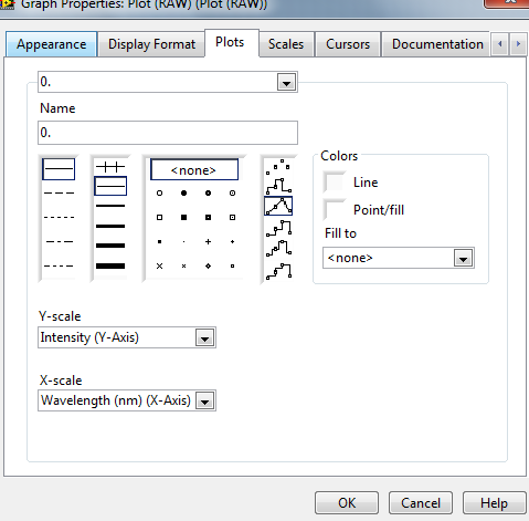

Hi, I have a program that tries to plot (wavelength, intensity) It is working as you can see that I am getting datas in the table. I also checked in the configuration that everything should be fine. I don't think it is because of how small those data are, do any of you have any idea?
We cannot see the connection between the data in the table and the graph. In order to troubleshoot, please attach the VI and some typical data.
Also, one column is all zero (as formatted), but no axis covers that value. What are the true values?
