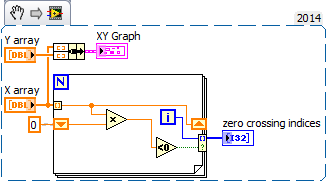

Hi Steef,
I need value from x-axe when y-value is equal to 0.
You have two arrays, one with X values, the other with corresponding Y values.
Search the X array for zero crossings and get the index of those zero crossings. (Hint: a ZeroCrossing is indicated by two consecutive values with different sign…)
Use these indices to get the corresponding value from your Y array.
To give an idea:
(Try to avoid DDT wires and ExpressVIs, they don't help to understand your own VIs!)
Next time you should use the AutoCleanup tool before uploading a VI… 😄

How I get this index?
Thank you for Autocleanup tool 🙂 I didn´t know that.

And what kind of wires should I use?
I have problem with that, I don´t know "divide" that array - in loop I can´t  compare this number/numbers with 0.

Hi Steef,
did you notice my snippet above?
Message 7 of 9

Hi GerdW,
yes, I do. But, can you sent me that file in VI? Thats could help me.
Steef
Message 8 of 9
(4,883 Views)
Hi Steef,
it's a snippet!
Message 9 of 9
