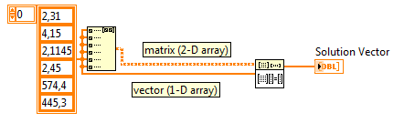

But I do want to perform matrix multiplication. See the image below.
If these were the time-averages of the voltages or anything else then I would be fine in setting it up, I just can't figure out how to do it when they are waveforms.
James

Accepted by topic author JamesVenning
Then do what I said in message 3.
You started confusing things when you started talking about applying constants to the entire waveform.  It is impossible to do a 6x6 times 6x1 matrix multiplcation if you are talking about every point in a waveform which is going to have more than 6 points.
Looking at your latest equation, is the 6 x 1 vector represent a single element in time from the 6 Waveforms?  If so, use the  first part of what I said in message 3 to convert your 1-D array of waveforms to a 2-D array.  Then iterate through the 2-D array 1 column or 1 row at a time (which ever dimension gives you the single time element from the 6 different channels).  You may be able to auto-index depending on the direction.  Then use that 6 element 1-D array to to your matrix multiplication with your 6x6 matrix.
