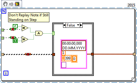

I am new to LabVIEW and I'm buliding the piano stairs that AshLu posted on the community but I am having problems with the code ( https://decibel.ni.com/content/docs/DOC-12384 ). When I use my own .wav files for each step sound I get error:
Error -1802 occurred at Add in PlayNote8.vi:4570001->MyDAQ8.vi
Possible reason(s):
LabVIEW: (Hex 0xFFFFF8F6) Waveforms have different dt values.
The VI is attached at the bottom.
 Any help would be appreciated.

Oh, I see your error, but it difficult to describe. Because my english is bad and your LabVIEW is low 🙂
I try.
All wave has same dt (2,26757E-5), but here
you sometimes replace original wave by zero-wave with dt=1 and 4000 points.
And finally you get array of waves with different dt.
If you will use the same file everytime, you can replase dt=1 in your wave-constants by dt=2,26757E-5
Message 8 of 9
(7,950 Views)
