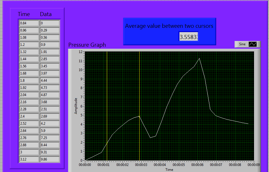

I have deleted "row 0" and the graph is better now, but is still incorrect 😞

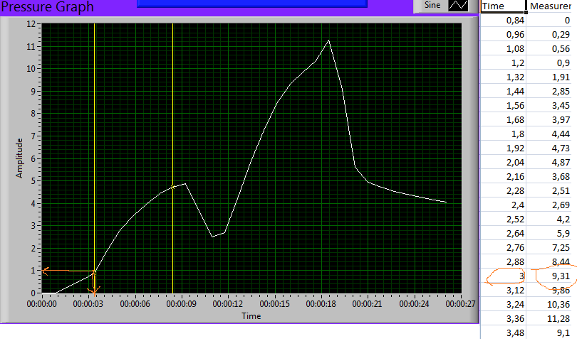

I don't see the same thing. I have an x axis with 0, .12, .24, .36, etc. That is exactly what I would expect with a dt=.12 (cheich is what is in your file). What do you really want to see?

The y-value is 4.7 after 3 seconds in the graph, but it should be 9.31 ?
