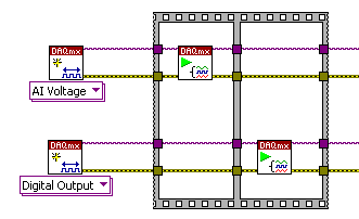

I think the best thing to do assuming you will be able to start your physical events with a 5V digital pulse would be to configure a digital write task and an analog input task in parallel.  First you would start your AI task, then your digital task.  If you need reference on programming those tasks you can find examples in LabVIEW under Help»Find Examples then select Hardware Input & Output»DAQmx then the respective category. Here is an image to show you how the two of these would look together(for illustration I haven't properly configured the DAQmx Create Channel VIs) :
 This would start acquiring data and then trigger your your event.  From the sounds of what data you would be capturing you would probably be able to tell where it starts!  Good luck!
