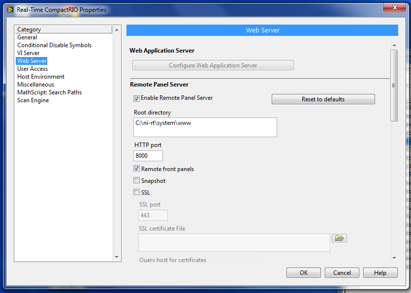

And this is how the web server properties are set up:

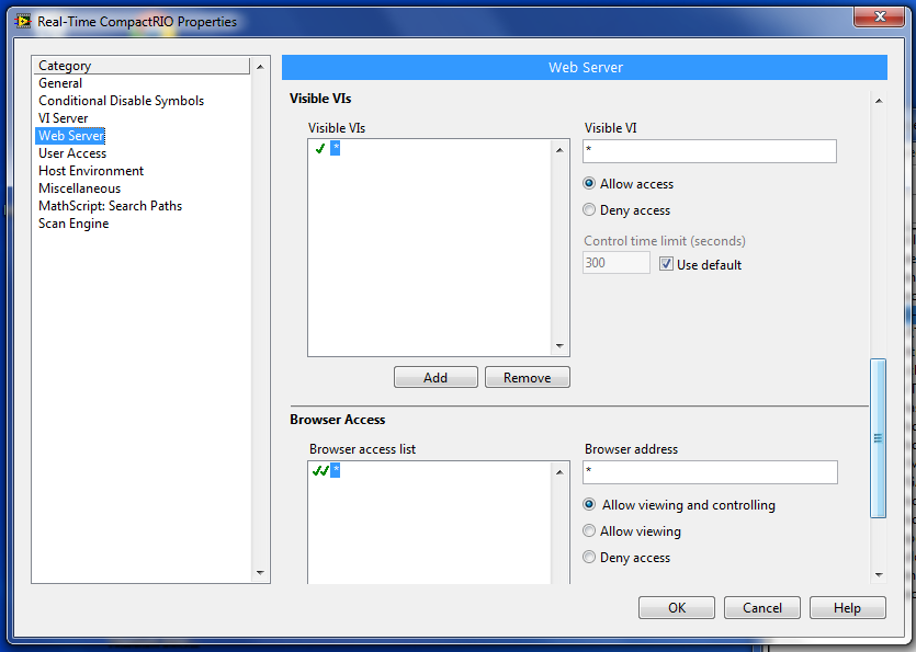

In terms of visible VIs and Browser Access I have left it as it is, since, from what I understand, the single star means 'access to all'. I have also done 'deploy all' on the RT and rebooted it a few times, but I still get the same error in the browser.

In your case as the visible vi's and the browser access are left blank, your application ini file will be complied with no vi name and no browser ip address.
i suggest you to enter the Vi name in the visible vi's column and also the IP address of the client PC from where u are trying to access the application. And also try changing the port what you have set to 80 or 81 instead of 8000.
And also do change the permissions to both view and control.
I hope this will help you..

Hello, thanks a lot for the answers, but the problem still persists, and I don't know why.
I have added the IP address and VI name (by the way, do I need to state the whole directory path or can I just write the name.vi, like Host on Rt.vi in my case?). With respect to "cross check the html file is in the application path", do you mean the same directory?

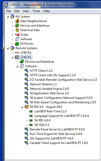

I don't know if this is worth mentioning, but the crio is connected to the computer directly using a crossover cable and a dedicated network card. Then, the PC is also connected to the internet with a different ip and different network card. And in terms of software installed on the RT, I think I have it all, but just in case:
Thanks a lot again

As a first thought by looking at your answer, once try with giving the exact IP address of the PC rather than the PC name. Also try with appending the port number what you have given for the browser like "http://100.100.100.100:80/RT.html"..
If still this will not work, then try making your development pc as server and your RT machine as client.
LV 8.0, 8.6, 2011,2012,2013 WinXP
