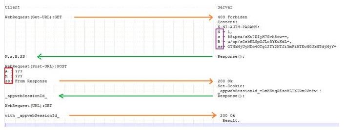

Any update on this discussion. I need some support on the following…
I have enabled web service in C-RIO and able to access the web methods from the Internet Explorer (with Silverlight installed). First time it always redirect to the NI authentication page... after entering user name and password, web method is getting executed properly.
Find below the normal handshake between Internet Explorer (with Silverlight) and C-RIO for NI authentication
Need support to do the same NI authentication from the C# code…  It will be helpful if you share any working sample code for the NI authentication (without Labview client)
From C# code:
I am able to get the ”N”, ”s”, ”B”, ”ss” values from C-RIO. I am getting stuck in calculating the “A” and ”M” values.
I hope to compute "A", we need the random number which is used to create the variable "B" in server, Please let me know how to compute A and M values in C# code.
Note: As a work around, I have created an DLL from Labview for NI authentication and included that DLL in my C# code then it works fine but client need to install NI run time engine also… We don’t want to install NI run time engine in the client systems.
