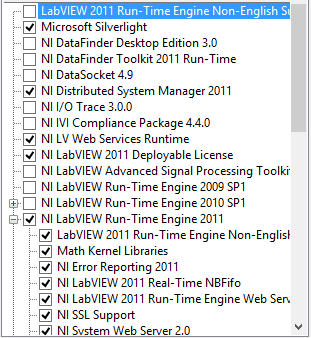

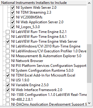

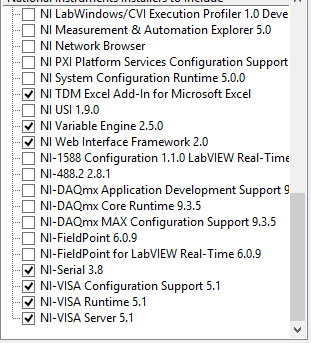

        I had created a webservice for my application and i put to serve a index.html when user accessing the webservice. In my development laptop, i deployed and i managed to access my webservice using localhost:8080\webservice . When i build an installer with my application and webservice and installed it on another new computer, i cannot access the index.html by default. It returns Access Error:404 -- Not Found. I need to use localhost:8080\webservice\index.html. In webservice build setting, serve default index.html for static document folders is checked. The file index.html also inside the webservice folder of C:\ProgramData. My application still working in the new computer , just i need to use localhost:8080\webservice\index.html instead of localhost:8080\webservice. I am wondering why i cannot access the webservice index.html by default in my new computer but i can access when i deployed on my development laptop. Maybe i missed include some additional installer? Here i attached all the addtional installer that i included in my application installer.

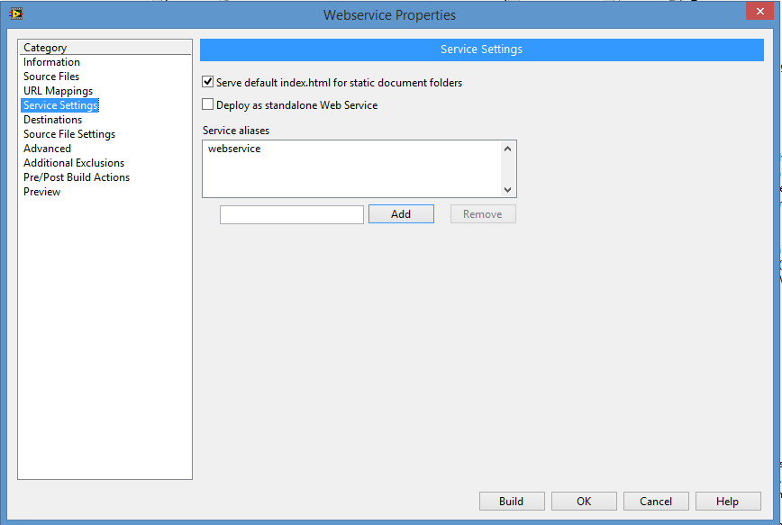

Sorry that i gave wrong information about my problem. I just notice that i cannot access to localhost:8080\webservice even is in development laptop. I am accessed  to localhost:8080\webservice\ before this. So now my problem is i cannot access to index.html using localhost:8080\webservice but succeed with localhost:8080\webservice\ or localhost:8080\webservice\index.html . Before this project, i had done some webservice projects but all works well. I had compared the configuration with my previous projects but i cannot found the different. Then, i notice there is service alias in service setting so i added "webservice" into the service alias. Now i available access using localhost:8080\webservice already. Maybe there is some insignificant different so i didt notice when i compare with previous project.  Btw, thank you for your answer.
