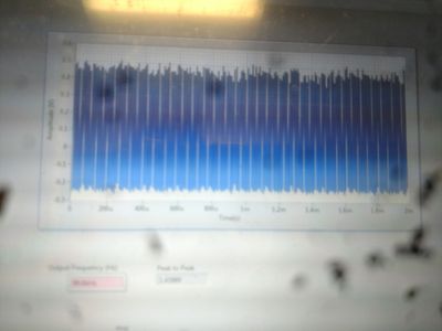

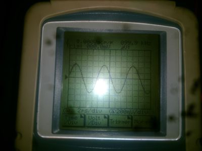

I hope this might help. This is what my extech meter reads and I trust that it's somewhat accurate however, my scope reads quite distant results in terms of the way the waveform looks and the peak to peak value I get using Amplitude and Levels Measurements express vi. Is there anything else I can provide that would help? I'm sending the amp a 100khz signal with an amplitude of 2v.
I'm sorry my phone camera just broke this is the best I can do for right now. My acquisition time is set to .02 which should be equal to 2ms just like the extech.I have set my sample rate to 200k which is double the frequency I'm inputting because otherwise it says I'm sending it 50 khz not 100. Trigger slope is rising just like the extech scope.
Message 16 of 21
(1,876 Views)
These images are useless. Please run your program until data shows on the "analog data" graph. Stop the VI. Right-click the graph...data operations...make current value default. Save VI under a new name and attach it here.

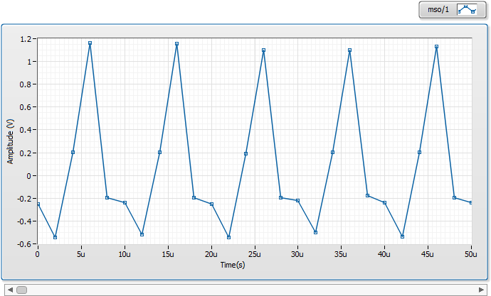

So you have a 100kHz signal sampled at five points per period and it looks like there are higher harmonics. Are you sure the real peak is not between the sampled points? Your p-p is based on 200 peaks. Tell me again why you think you need to do a ptbypt average? This looks nothing like you see on the oscilloscope.
What are you trying to get out of it?
