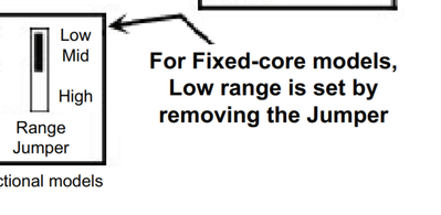

Well, I'm expecting a value of 3.5 because I'm converting 4-20mA to workable voltage for the DAQ. I'm using a 500Ω resistor to do so. The power supply is outputting 3.5 amps, and I had about 2.24V across the resistor.
Anddddddddd I just realized after typing that out what the issue is. I'm trying to scale it 0-200 Amps, but the jumper is removed so the range is actually 0-50 Amps. Woops. Thanks guys!

Sorry to nitpick, but something still seems off.   Scaling 2.24 V where a 2-10 V range maps to 0-50 A should give you 1/4 of the ~6.5 I referred to earlier, so more like 1.6.   Still not 3.5.
I understand that (as far as you know) the real world *actual* current might be 3.5 and that's why you're anchored to it, but the ranges and voltage measurements you've presented don't get you there.  Just looking to emphasize clarity.  The deifference between a 0-200 A range and a 0-50 A  range doesn't *actually* explain what you've observed so far.

2.24V probably doesn't represent 3.5A anymore after putting the jumper on the correct spot. I didn't measure the voltage across the resistor, but after doing that I get a current reading in labview of 2.7 - 2.9 amps (it fluctuates a little) while my BK 9201 power supply shows 2.9999 amps being drawn from it, when I have the current output set to 3 amps. (In the example I just gave, forget about the 3.5A, I changed it to 3A earlier today).
