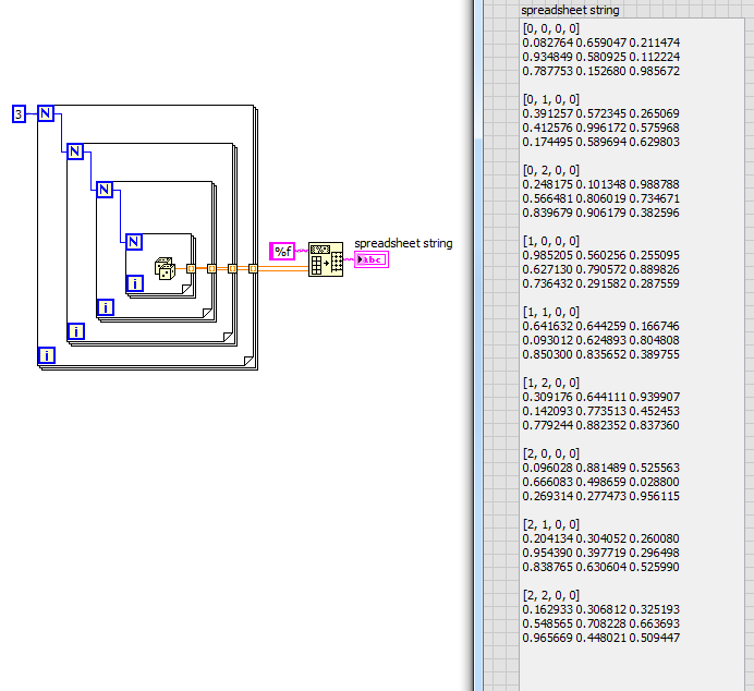

Hi hkpark,
I am trying to load the 3-D or 4-D array via a certain format of file to Labview.
Because .csv only deals with 2-D array, I am looking for the best file format for the case.
LabVIEW can easily handle arrays with more than 2 dimensions in a CSV file:
You just need to follow the format used by LabVIEW (as described in the LabVIEW help)…
