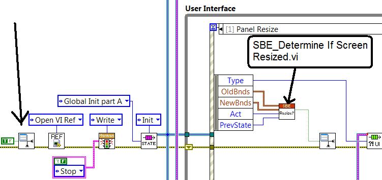

I resize the Front Panel when the program start to fit the monitor resolution.  After that, I use the "SBE_Determine If Screen Resized.vi" from TomBrass (http://forums.ni.com/t5/LabVIEW/Resizing-controls-on-a-tab-control-within-a-pane/td-p/1520244 ).  This vi is very useful if you don't want to monopolize the CPU with the "Panel Resize" event.

I don't like this function for a couple reasons.  First for the example you don't need any custom code to handle the window resizing, just use a couple splitters.  Even if you did need to handle the resize, you only resize after the mouse is up after the resize which is not how normal Windows programs work they resize as the mouse moves.  So I modified the VI to resize objects as you resize the window.  Then because doing this can generate 100 events very quickly, I use a boolean in a shift register to make sure that we only handle the resize event if there is no new resize events after 0ms.  This essentially makes a lossy queue and handles the last resize event.
