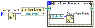

You'll never be able to fully stop it, simply because the act of using an event structure to trigger on a user event will expose the reference in any case through its event data node:

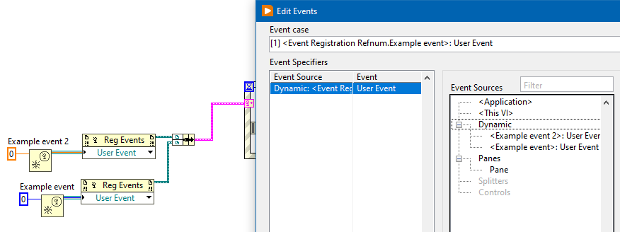

If you do go with your strategy of registering in a class method they can't access, it's not hard at all for them to register for other things.  Event registrations can be merged with a simple bundle node:

Ah true, I forgot it exposes the reference in the frame.
I didn't know you could bundle the registration refnums like that. I know you could register to multiple events or nest events in bundles, but not the registration itself. Good to know, thanks!
