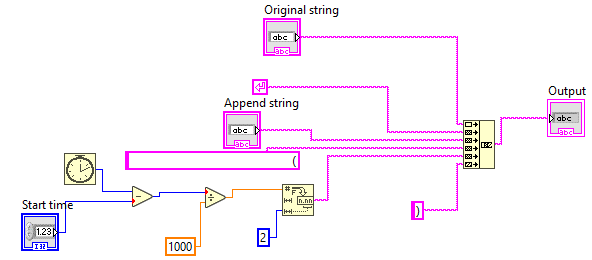

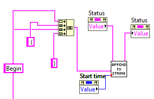

I've done this so far in a way that works, but is obviously pretty derpy. I basically create a blank "status" string, and then have a subVI that, when you pass it the status string and the string you want to update the status with, it appends to the status and adds a time since the program started. Like this:
and the function looks like:
and... this works, but I'm betting there's a smarter way to do it in LV.

Hi, I am indeed using a state machine with real states/shift registers/etc.
Hmm, I see that I could do that... however there are often little flat sequences within a given state (that don't really merit making their own sub-state diagram) that I'd still like to print to the status.
Hmm, why would I use that vi? I mostly just want a time elapsed since the program started, and the "time elapsed express vi" confuses me...
