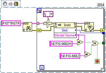

Try something like this to get names and slots. You can then filter the results.
Cheers,
mcduff
EDIT:
Use the VISA FIND RESOURCE function to get a list of installed components, then use the snippet to find out what slots they are in.

Here is a snippet where I look in a PXI chassis for a GPS module that can be either a 6682H or 6682. If it is found then the for loop returns a true value.
I assume you know what modules, or at least have a list, of the possible modules that will be in the PXI Chassis. Here if I find the GPS module in the chassis I initiate it, if I do not find it, then I do not use it in my program.
I would suggest you have a list of possible hardware and if it is found then proceed with the initialization, etc. I would recommend doing this automatically and not having a user pick from a list.
Once you perform an initialization and know what is in the hardware it is possible to create an ini file such that you do not have to cycle through the chassis to determine what is in there. However, I discourage this, as hardware may be added/subtracted from the chassis and thus your ini file would be invalid.
