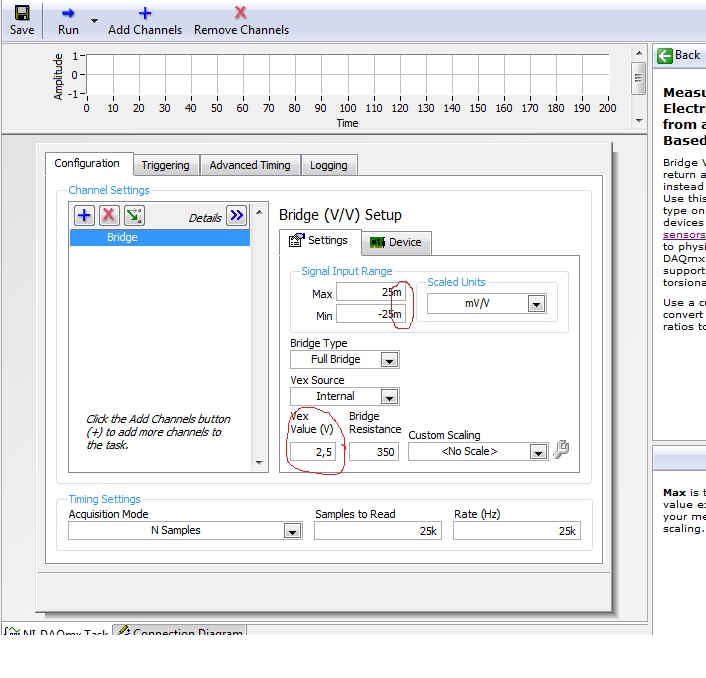

in MAX, i create a new simulated DAQ,I choose, bridge/channel. I choose, mv/v and the others,thats ok. But what does "m" and "Vex value" mean?
Furthermore, how can i import this simulated DAQ to LAbView? If I go to labview and insert a DAQ, that is a new one daq, and not this one.
Khank you very much! I appreciate your helps!
Message 9 of 13
(3,904 Views)
m means milli or 10e-3.  So you hav +25 millistrain to -25 millistrain.
Vex means Voltage-Excitation.
You create a task of whatever name you want that shows up in Data Neighborhood.
Later when you get the real device, create another task.  Use the new taskname in your code.
Or delete the old task and create the new real task with the same name and you shouldn't have to change the task in your LV code.
