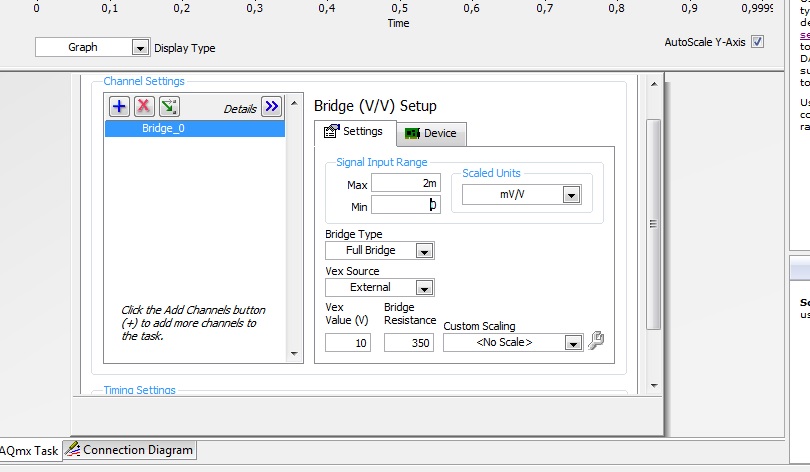

So if I have a load cell, and the sensitivity is 2 mv/V, the supply voltage is 10 V, then the maximum signal output from my load cell is 20 mV. Therefore, i have to set the parameters like this:  haven't I?

I just set the range to be something like +/-10m which would be 10,000 microstrain which is usually a larger number than I ever expect to see.
I can't give you a whole lot of specifics.  Exactly what to put varies from application to application.  I play with it, learn, and adjust.
