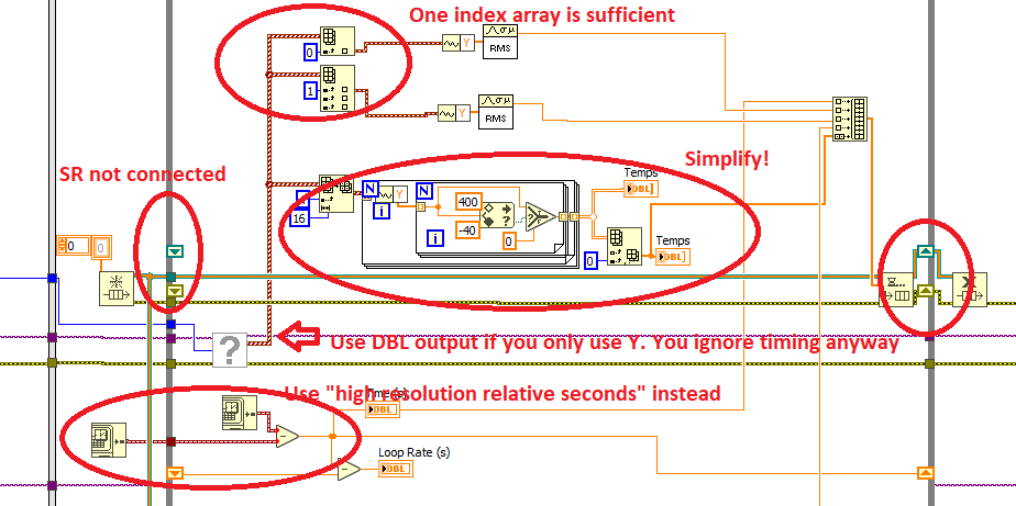

On a side note, you might want to look at your code more closely. There are a lot of weird things going on.
A few small examples (I move the shift registers up slightly to show that they are not connected on the left):

Altenbach, Noted, the tunnels should have should not have been there and the wire should be connected to the shift registers.  For the TC, any channels without a thermocouple give me a large number.  I am just filtering that out.  Noted on the dbl output.  I just created this vi from my large vi that was needing the waveform.  I try the high resolution seconds and get the same timing values (at least to a few decimals).
