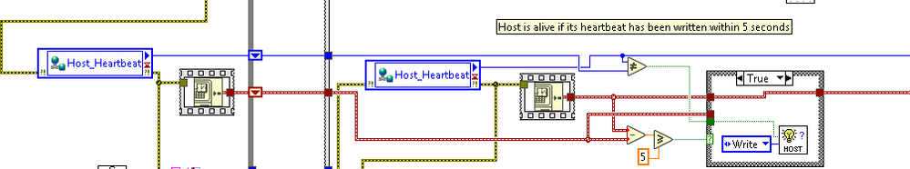

I asked because I wanted a reliable way to determine if my host is still active (So I can gracefully shut down my RT app on loss of the host).  I use NSVs for this since they are independent of VI operation (I could use a network message instead I guess).
This is a snippet from my RT watchdog process.  Since the NSV timestamp isn't referenced to the RT clock, I have to get a RT timestamp along side each NSV read to determine when to check if the NSV value has changed.  I sure wish there was an optional error in to the timestamp VI.  I really hate having to use flat sequence structures like this.
The HOST vi is just an FGV that my RT main uses to determine if the host is alive.
