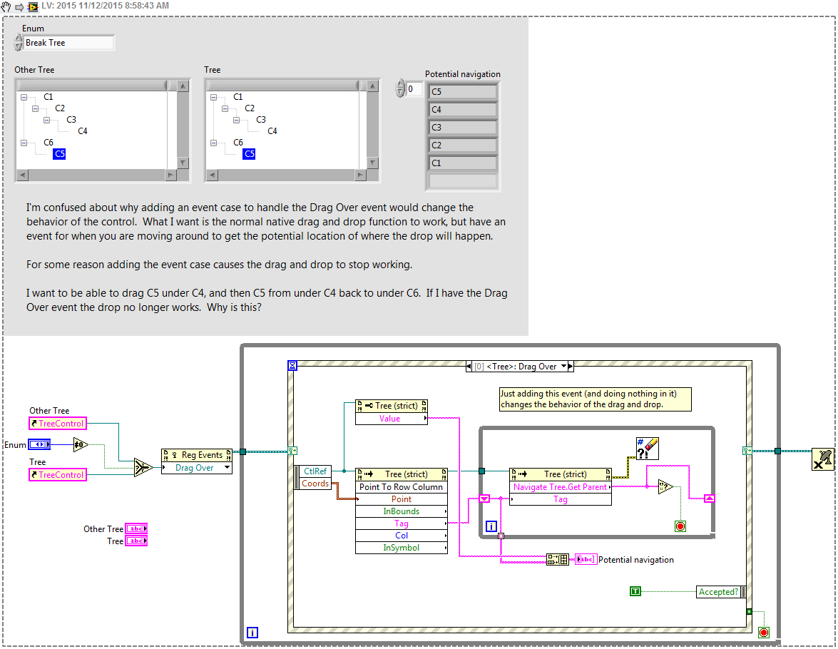

Okay this has bothered me for a while but I just thought it was one of those "Well that's how LabVIEW does it" and I want to make sure that I'm not missing something.
I've noticed on many controls that drag and drop works well as long as you only care about the value of the control.  But often I'll want to know how a drag and drop operation went, and then re-arrange other data based on what the user did.  The logical method of doing this is to create events for the various drag and drop operations, and reorder the other data associated with it.  The problem is when you add events to handle the drag and drop, the drag and drop functionality changes, and the built in stuff no longer works the way it did.
Usually for me this means re-writing the drag and drop functionality in LabVIEW to get the features I want.  But I always feel like the native drag and drop gets me 90% the way there, and it takes a decent amount of time to re-write it.
So attached is one such example.  It comes from a post on the forums, but the concept is something I've seen many times.  At the start I register for one of two tree controls to have the Drag Over event, so that you can read where the mouse is over when a drag is taking place, and then determine where the drop will land if the user lets go.  But as soon as you register for a Drag Over on that control, dragging and dropping no longer works.  Why is this?  Is there an easy way to preserve the native LabVIEW drag and drop, but have some of the events for various drag and drop operations?

I know not everyone has 2015, but the snippet above shows one of the two event cases, and the other is Panel Close?  When I was trying to replicate the drag and drop functions I often would add mouse move/enter/leave events but for this example I wanted to simplify it.
Literally the only thing this VI does is register for a Drag Over event on one of two controls, tries to guess what the tree would look like if you droped (by using the get parent over and over), and stop the VI if you close the front panel.

Hello Hoovahh,
I have looked into your question and found that there is a Corrective Action Request previously filed. The CAR is 90595.
In the CAR it states that this is the expected behavior for LabVIEW. The reason is if the user registers for a drop target event, the user has to implement the drag and drop behavior them self; LabVIEW will not do the built in behavior any more. This was done for several reasons, most notably, LabVIEW does not know if the user has already performed some drop operation that is inconsistent with built in behavior.
Assume that the user already moved the tree item into the tree, for example. Then LabVIEW would end up moving it again resulting in a double move which would not be good.
I hope that this helps you out.
Yes it will.  There is the Accepted? output in the event structure case for the drop which I can set to false which would tell LabVIEW not to do the drop and I'll handle it myself.  Or if I put a True to the Accepted? It should tell LabVIEW that I want it to perform the default operation and accept the drop the user just did.  What is the purpose of this event being a filter event, if it isn't for telling LabVIEW to accept the drop?
