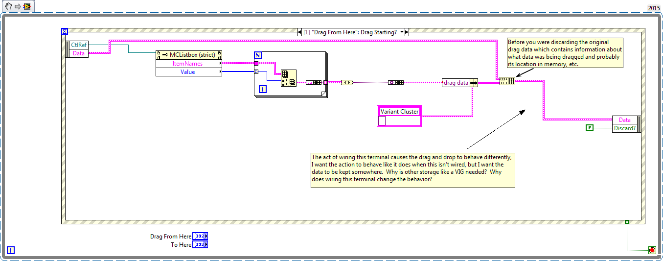

Hey there!
So I think your issue is simply that you were discarding the information LV needs to complete its Drag Drop. Most likely contains information about what data is being dragged and where it is located. The snippet and the attached VI should fix the problem.

Why can't I give you more than one kudo?  Seriously I didn't know that was necessary.  Don't get me wrong there are still several issues I have with dragging and dropping, but this one was because of something I just didn't realize.

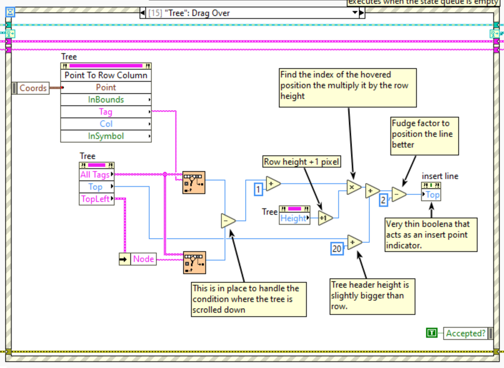

Did anybody figure out how to get the "insert between" line back when filtering events?
When I drag 'a' over to drop it between 'a' and 'ASF', the default behavior is to get a line.
But I want to disallow dropping on some items.
The moment I add a Drop Over event, the line is gone, even if the Drop Over is always accepted.
Spoiler
I tried to use Mouse Move to somehow filter, but Mouse Move doesn't trigger at all when dragging.
I tried to use a dynamic event (Drag Over and Mouse Move), but that doesn't make a difference.
I tried to use a callback event, but that seems to simply break all dropping. Even if accepted is true, do drop is accepted.
The only 'solution' I could find was LabVIEW-Drag-and-Drop-in-Tree-using-event-structure, but that's a bit too clumsy for me (Using an action engine that sets the cursor to a 'fake' line cursor).
EDIT: Tried to see if dynamically registering\unregistering for the Drag Over event would trick LabVIEW into drawing the line. It doesn't. LabVIEW hangs infinitely, and task manager needs to close it.
Message 19 of 21
(5,987 Views)
I ran into this recently and the solution I came up with was to use the Drag Over event to live track the mouse and then position a very thin (1pxl) boolean at the insertion point. You can make it snap in place by multiplying the item index by the row height. This makes it behave the same as the built in effect.
