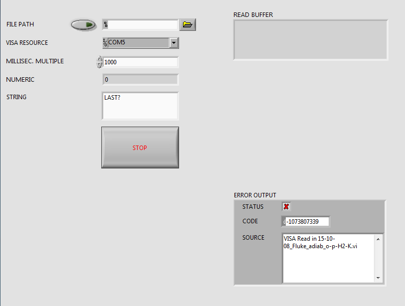

Now I tried this... as you can see, the Read Buffer is empty.
Message 13 of 23
(2,380 Views)
You aren't appending a termination character with your write. Look in the manual to see what is required. It should be either a line feed or carriage return. You must right click on the control and select \ Codes Display and use \n or \r.

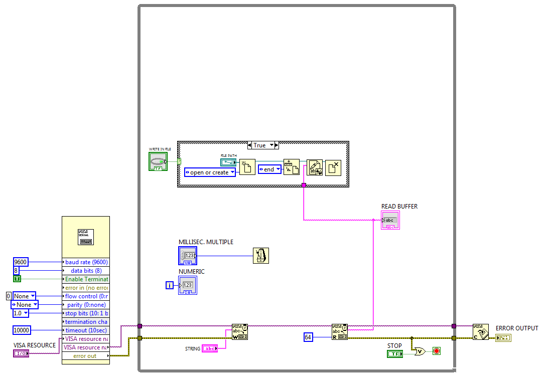

I dont know exactly what you mean, but i added my program at the attachement... maybe you couldt show me what you mean?
Message 15 of 23
(2,352 Views)

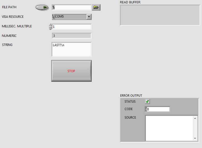

Right-click on your string control and choose '\' Codes Display.  Now put a "\n" at the end of your entered string.
Message 16 of 23
(2,339 Views)
Now there is no error message any more... but the ReadBuffer is still empty.
Furthermore, i can see that the milliseconds multiple has no influence anymore... however what i put in.
Message 17 of 23
(2,324 Views)
You aren't supposed to get any error until you stop the while loop. Have you looked in the manual for the correct termination? Did you try a carriage return? Did you try CR/LF?

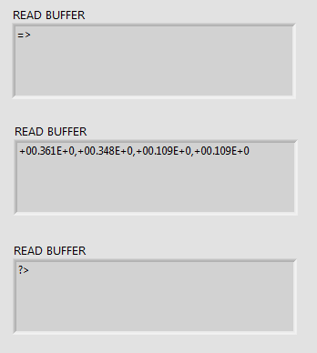

After some settings (in aid on your advices) i got as far,
that my buffer shows me the string... but in 3 alternating displays.
Actually only the second display is that what i need.
Can somebody tell me why?
Message 19 of 23
(2,303 Views)
What is the exact model of your instrument?  Whatever you are getting is specified in the user manual of the instrument.
