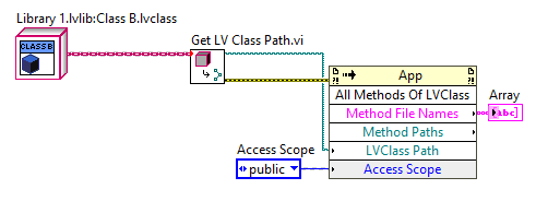

When invoking the LabVIEW Class:All Methods Of LVClass, it returns fully qualified names of the Class A methods which have been overridden by Class B methods. Shouldn't it return the methods for the class specified and not its ancestor?
I can understand this behaviour for methods which don't have an override, i.e. Method 3., but not for ones which override it in the specified class.
Is this a bug? Are there any other methods that allow you to obtain all of the public methods of the child class at run-time?

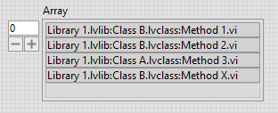

Actual output:

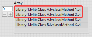

Expected output:
Expected outputExpected output
