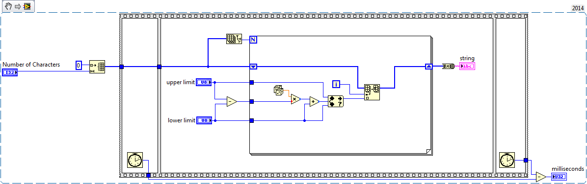

You're on the right track. I did some more testing. I modified my Random String Generator as follows:
This now allows me to generate a string of random characters within a specific range. I localized my PC to "Chineese"  and ran this VI continuously and timed when the string indicator updated with a stop watch and compared that to what the VI would calculate as timing.
With the string indicator configure as Normal Display and "Number of Characters" equal to 2 million, here are my results.
  • Lower Limit = 0x21 Upper Limit = 0x7E. This represents the range of normal, printable Latin characters. Stop watch = 1.5 seconds per run
  • Lower Limit = 0x00 Upper Limit = 0xFF. This represents the entire 256 byte ASCII range. The output will be a mix of Latin characters and Extended ASCII characters which will be localized. Stop watch = 21 seconds per run
  • Lower Limit = 0x81 Upper Limit = 0xFF. This represents the range of only the extended ASCII range that will be localized text. Stop watch = 44 seconds per run
When I perform the same set of tests with the string indicator set to Hex Display, I get a timing of about 1 second per run across the board. Additionally, the value of the milliseconds indicator was always in the same range, between 174ms and 178ms, in every test.
This tells me 2 things:
  1. The delay is occurring post VI execution.
  2. The number of characters outside of the printable range in a string is directly proportional to the delay (on a computer localized to about anything other than English) it takes to update the string indicator if the indicator is set to Normal Display.
Hopefully all of this information is useful to someone at NI.
