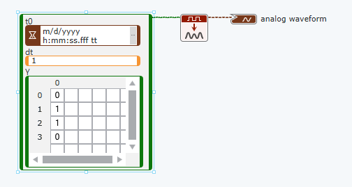

Why does a digital 0,1,1,0 convert to a -1, 0, 0, -1?
Using Digital to Analog waveform function why does the following:
0
1
1
0
convert to:
-1
0
0
-1
Code:

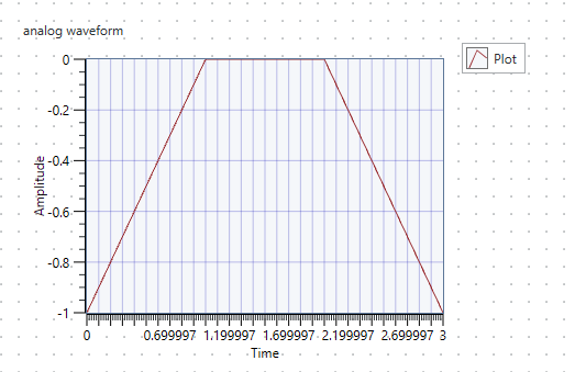

Result:
I was expecting:
0
1
1
0

The data format defaults to offset binary, you want unsigned binary.
