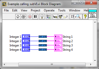

When I call the subVI the custom icon is the desired size.

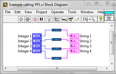

When I call the packed project library, the icon goes back to the default full size. The border is not visible, but this example shows four copies after being selected on block diagram and  vertical compress selected.

Was there ever a resolution to this issue? I am seeing the same problem in LV2016 when I build a "bullet" style VI into a PPL.
(3,514 Views)
When we asked NI this question a while back we were told that PPLs always use a full size icon. We were never given a good explanation as to why though.
