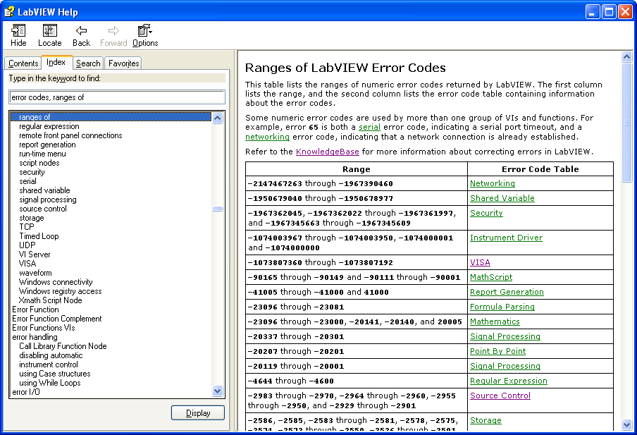

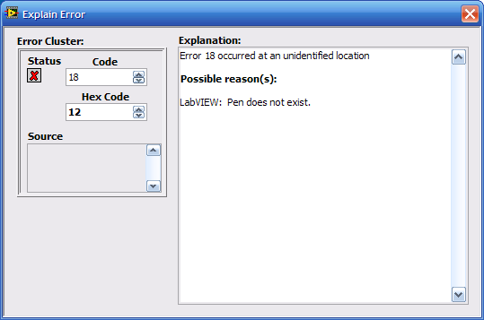

That's funny, it seems the link posted is the same information as opening LabVIEW Help and looking at the Index tab for error codes. I also sometimes use the Explain Error popup if my program doesn't have an error cluster.
The pen is mightier than the sword, unless error 18 occurs... Smiley Wink

If you have an error indicator, you can simply right click on it and select 'Explain Error'. The actual error codes are in files in your \resource\errors\English folder. They are also listed in the on-line help. The link you posted has the same exact information as the on-line help.
Where exactly did you get this error? It's possible that whoever wrote the VI created an error code that did not follow the guidelines or was written before some of the guidelines were in place.
