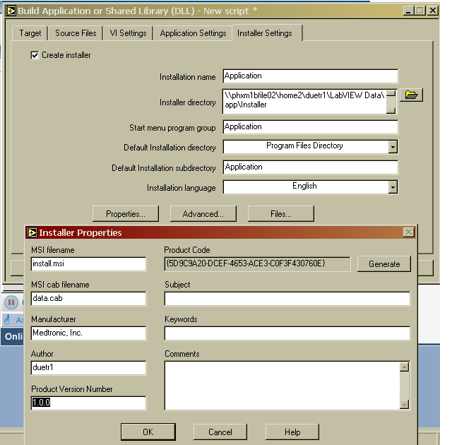

Unfortunately the application builder does not contain a location to enter a version number.  I would like to see this feature also.  You could build an About.vi and manually change it every time you make a change and recompile.  If you create an installer on the application builder, click on the Properties box and you will see a place to enter the version number.  But I think this is the version of the installer, not the application.  This may still be usable but I don't know how to retrieve this info programatically.

Although I have 8.2 installed, I use 7.1.1 mainly.  The picture I showed is from the 7.1.1 app builder.  I'm glad to hear that 8.x has this feature.  Sooner or later we are going to migrate to the latest version and I'll start using it rather than just play with it.
