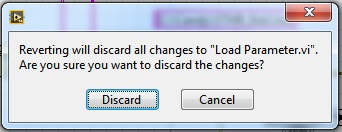

Why i countinuosly get this messages opening a vi from my project?
I need an help to understand why i get this message when, after i modified something, I open a vi from my project:
and after clicking revert..
After re-opening the vi the error does not present himself anymore and the functioning of the development system it's ok.
Thanks in advance.

Sounds like you opened a VI outside of the project and then saved it while the project was open with the VI loaded due to it being in a library or class.  Can you give any more information on the work flow you use when you get this error?

Nothing to complicated. I just open a vi inside the project containing it, this vi it's not open in another way. I'll try to find a sequence of action that trigger this event.

-How you are calling the "Load Parameter.vi" in your VI?
Few points read in forum related to it:
-If any Subversion is working in behind and is it changing the timestamp of VI?
-Any Virus scanners also could change the vi timestamp. Source: http://forums.ni.com/t5/LabVIEW/Labview-8-5-prompts-me-when-I-change-a-subvi/td-p/579867

I think i got it, thanks to your hint about the timestamp of the VI. I was working directly on our backup server and this was messing with the timestamp. Now i switched back to my Hard Disk and the problem has not show up anymore!
