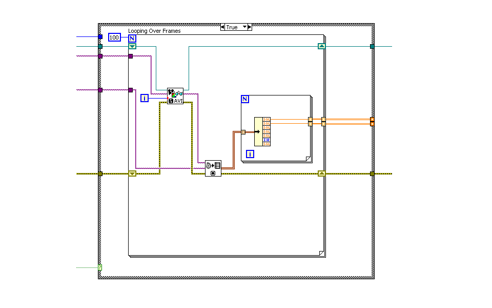

Norbert,
Thanks for the reply.  I've posted a picture of the subvi.  It's relatively simple with no explicit wait functions.  Any additional input would be helpful.

Ken,
the AVI Read has an implicit delay included caused by the framerate of the video you are reading. If the fps (frames per second) of the video is e.g. 30, you will have to wait between two frames 1/30 s =  33.3 ms. During this waiting time, the Profiler does not show the calling VI as active. The tracked time taken in the caller does only contain the loop and the call to IMAQ AVI Read Frame.vi. Not the time this subvi takes.
If you look into the time taken by IMAQ AVI Read Frame, you won't see the "waiting time" as well, since it is again only a function called by this VI.....
hope this helps,
Norbert

(3,880 Views)
Brilliant!  Thank you - I would have had a tough time figuring that out.  That is for sure what the problem is. That seems like a strange "feature" of the AVI Read Frame.vi though.  So if I want to process an AVI video as fast as possible, is the only way to change the framerate of the AVI?  What about the frame read "lookahead" parameter - could that do it?

Norbert,
I wasn't implying that waiting for an event should show up in the timing statistics.  Instead, I was saying that it's strange that the AVI Read Frame has a built in and undocumented wait based on the frame rate of the AVI.  This makes it difficult to process an AVI at any rate except the native frame rate - In my case I'm taking long movies and I want to analyze them afterwards as fast as computationally possible.  As far as I can tell I will have to convert frame rate of the video outside of labview first and then process it in labview to achieve this goal.

(3,853 Views)
Update: I think the timing problem was actually due to the profiler not counting hard drive read time.  When I changed the frame rate of the avi from 15fps to 60fps, I got exactly the same timing statistics.  My avi read performance seems to be limited by my hard drive speed (Running the same program on a faster hard drive increased my speed).  Perhaps the AVI Read Frame.vi is considered to be finished executing when the hard drive starts transfering the data, as opposed to when it is finished?
