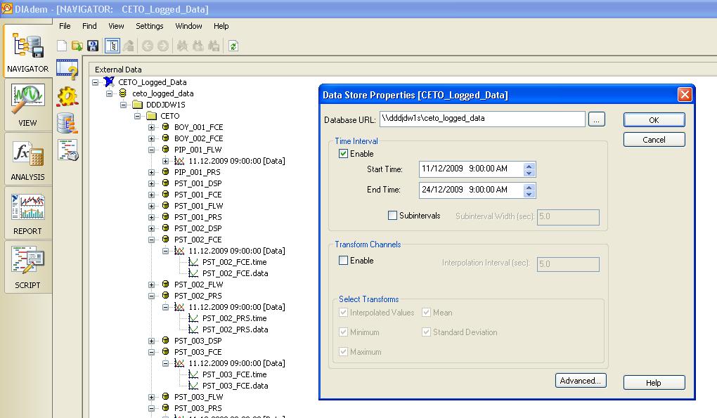

Hi Eric,
OK, here is an example. Below is a screen shot of the DataStore range I am requesting. When I drag the PST_002_FCE channels to the Data Portal, I get the range requested. When I do the same for PST_002_PRS, I get the following range:
11/12/2009 09:00:00.0140
14/12/2009 14:01:29.2020
However, there is continuous data in PST_002_PRS between 14/12/2009 14:01:29.2020 and 24/12/2009 09:00:00.0000, it is just not being acquired by DIAdem.
Trying other channels yields similar results, but with varying end times. There seems to be no consistent error.

Where you able to export that specific trace to a text file from MAX?
What is the data type of the failed trace?
--J.D. Robertson
Senior Software Engineer
Message 8 of 14
(3,671 Views)
Hi J.D.,
I have never had a problem with text exports from MAX. I did export the failed trace as text, but could not load it into DIAdem as it was too large. This was the error message I got.
The data types of the channels in the failed trace are time and numeric.
Cheers,
PorridgeMan.
