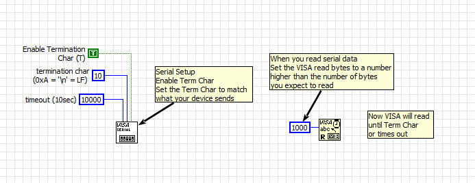

What is the return count value of the VISA Read function when you receive data and there is an error 107367629? You might ask for more bytes than the equipment is sending therefore the timeout error. Can you set a termination character instead?

Sorry man, you know most of us here have jobs and help people on this forum in our spare time expecting nothing in return.
The first question is how is the serial data formatted? Does it have a termination character? That is to say does the data sent from the device always end with a carriage return or new line character? Most serial device do this.

Dear RTSLVU,
Thank you for paying attention to my problem, and thanks so much for clearly solved my problem,
You were right.
