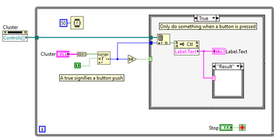

1) Actually if you probe shift register "A", you will see numbers being entered (there are other issues)
    Your "None" case wipes out the data going to the "Calculator Display 2" indicator.
     "None" of course runs all the time except for the short period when a button is pushed.
     Because of #2, this period is very short.
2) You should have a wait in you loop -  say 50 ms - save the planet and your CPU
3) The Array index nodes can be expanded rather than have to enter numbers for individual nodes.
4) Anytime you have to wire a whole bunch of nodes like this, consider that there must be another way
    This example (file attached) shows a way to get the button labels directly:
Founding (and only) member of AUITA - the Anti UI Thread Association.

The nice code submitted by @stevem181 is very nice, but misses the "hard requirement" that this code needs to run on a myRIO, which runs LabVIEW Real-Time Linux.  All of your Boolean controls are "latching" controls, which do not work as Front Panel Objects in LabVIEW Real-Time.
There is something really strange about this assignment.  It would be nice if the Original Poster could attach the actual assignment -- either there's an error in the Assignment (the Instructor doesn't realize "you can't do that"), a misunderstanding about the Assignment (Steven M misread or misinterpreted some aspect of the assignment), or something else weird is going on.
If you Google "LabVIEW Restrictions on Real Time", you can find some NI articles that explain the "Front Panel limitations" of the Linux Real-Time OS that they use.
Bob Schor

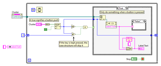

Here is an updated example based on stevem181's.
Keys' mechanical action has been set to Switch Until Released to simulate your keypad. To counteract the repetition of digits that comes with not having a latching action, you could just rely on the loop time wait function and set it to a comfortable rebounding time for your keypad. In this case, though, I have set the case structure to go through the False case if the key has not yet been unpressed after the first iteration, which is much more comfortable than manually setting a rebounding time.

Here is a version with buttons set to Switch When Released.
