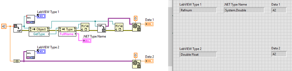

These are completely different sets of functions:
"To Variant" wraps any data type into a LabVIEW Variant.
"Variant To Data" unwraps the data back to its original (strict) type.
These are used when you want to pass generic data around your application.
"To .NET Object.vi" converts simple LabVIEW types to their .NET equivalent:
 - Double Float -> System.Double
 - String -> System.String
 - Boolean -> System.Boolean
 - Time Stamp -> System.DateTime
 - Path -> System.String
 - .NET Refnum -> the same .NET reference
 - Array of String -> System.String[]
Other types such as enumerations, clusters, LabVIEW-only refnum types… are not supported and will throw an error.
".NET Object To Variant.vi" does the opposite and tries to convert a simple .NET object to its LabVIEW equivalent.
These 2 functions are generally not needed since LabVIEW automatically converts properties and method parameters to their LabVIEW equivalent. You only need them in case the .NET property/method takes a generic Object as a parameter.
