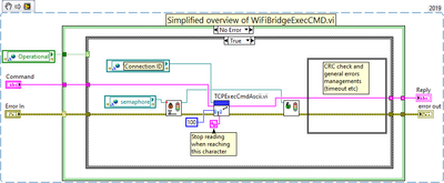

But the program uses tons of parrallels loop that aren't synchronized nor organized in any way and these loops often call the wifi vi with their own commands as input. Result is I receive too often the "wrong" answer : Requested ?H, but receiving the answer to ?S.
It's difficult to share any code at all as it wouldn't be working anyway, but below are a few pictures to illustrate what I'm struggling with.
The guy has been using semaphores in the wifi vi to avoid conflicts, but it's been proven ineficient.
I tried to reduce the number of time this VI was called everywhere (by increasing the loops delays), but still, no good results.
I'm trying to find a solution without having to re-do everything, being myself not very well experienced yet, that would take me way too much time. Any suggestions other than "burn your computer and start over", are very welcome 😄
I have to put a trigger warning somewhere, this code uses an excessive amount of shared variables. The connection ID and semaphore are initialized at the beginning.
TCPExecCMD.vi :
TCPReadString:
And here is an example that illustrate globally what the program does in term of parrallel calls:

PS: I'm also considering getting rid of the semaphore.
The wifibridge VI having its execution state as "Non-Reentrant", it should anyway avoid simultaneous Write/read on the TCP line, no ?
