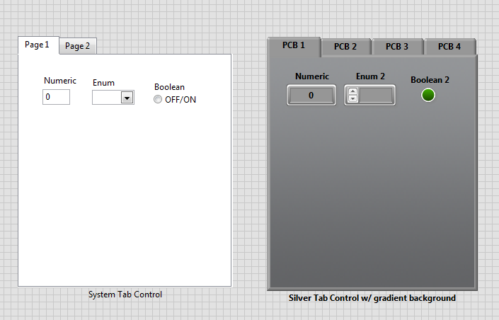

This is the difference on my computer. Are you getting more colorful backgrounds on your System Tab Control? The unselected tab seems to have a gradient to it, but the selected tab and it's associated background is just flat white with hard edges on my system...and the controls are all very simple, colorless boxes with hard edges as well. I'm running windows 7 Pro, 64 bit.

Yup that's what system controls look like on Windows 7 -- and not just in LV. The point is that they track the appearance of the default system controls for the platform (and display theme) you are using. Load your VI onto a system that is running a different OS (like XP) and they will look like XP controls. Select a different display theme and they will track the change.
If you don't like how the system controls look, complain to Bill Gates.
