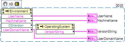

Here's one using .NET Property Node of the mscorlib System.Environment Class.
