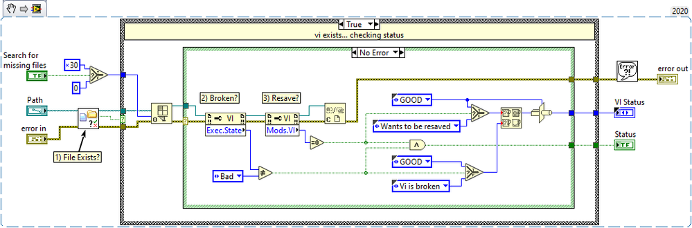

Here is another case of where the code runs in the IDE but not as an exe. Well OK, it does run in the exe in a lot of cases, however, in certain circumstances the exe crashes & disappears.
This is pulled out of a much larger project but left pretty much as-is.
The code is simple enough as see above (deliberately). Run the code from LV IDE with it pointed at one of your simpler vi from your GIT repository (or your Source Code Control [SCC] of choice). It probably reports as "GOOD". (I hope)

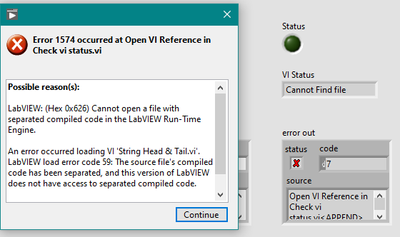

Now build into an exe and point it at the same vi and run it... Assuming you have followed good SCC practices, it should with pop up an error saying something about missing compiled code. Unfortunate for me, but reasonable after you think about it.

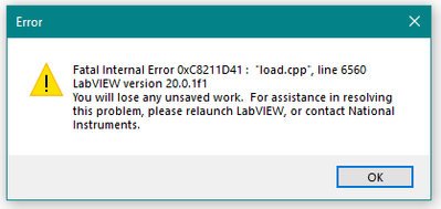

Now sift through your code and find a larger more complex file (larger than approx 150K) from your SCC repository and run it again. Observe how exe just disappears without warning.
It seems to be size related but probably related to the number of missing sub-vis (due to the missing complied code)
If you set the option to search for missing vis, you will sometime get a pop up error before exe disappears.
I hope I have describe it in enough detail and hopeful save someone many hours of debugging (like I just went through)
LV should probably be fixed to handle this case a bit more gracefully.

Unfortunately, it is the open reference that is causing the crash with missing compiled code, as seen in the original post.
My attempt to check for compiled code first (seen below) still causes the exe to crash/disappear ☹️
Guess I will have to put a note into the readme file about the potential crash using dev code. Not an optimum solution.
