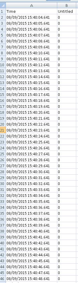

The DAQ has 96 inputs so in my block diagram I have a 1D array output of 96 elements.  if I write the 1D array output using Write To Measurement File VI, it will write all the outputs in one column... but I want all the output to be displayed in one row, and append the values in subsequent row.
For example, it is currently displayed as:
But I need it to be displayed as

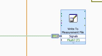

My block diagram looks like this
How can I do it?

To get that result you need pass your 1D array through an array builder with only one input. Logically, this creates a 2D array with only one row so it should store as you want.
Mike.

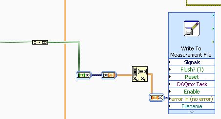

Thanks for the input. Though I used a different method but the 2D apporach is pretty much the same and got me the result I wanted:
I used Build array VI -> Convert to dynamic data type -> Convert from dynamic data type -> transpose matrix -> convert to dynamic data type2.

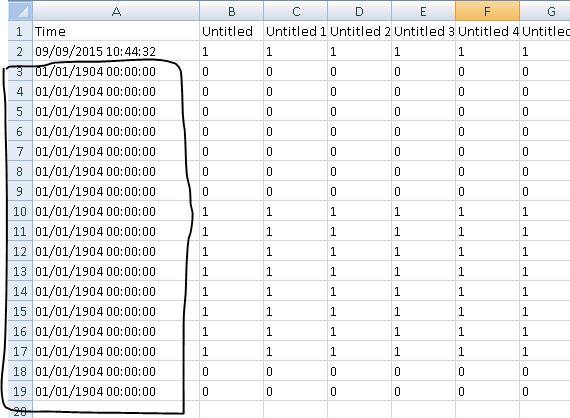

This may not be a big issue, but the Time Column appeared in excel sheet seems to be only correct at the first row. The subsequet row always shows 01/01/1904 00:00:00.. How can I fix this?

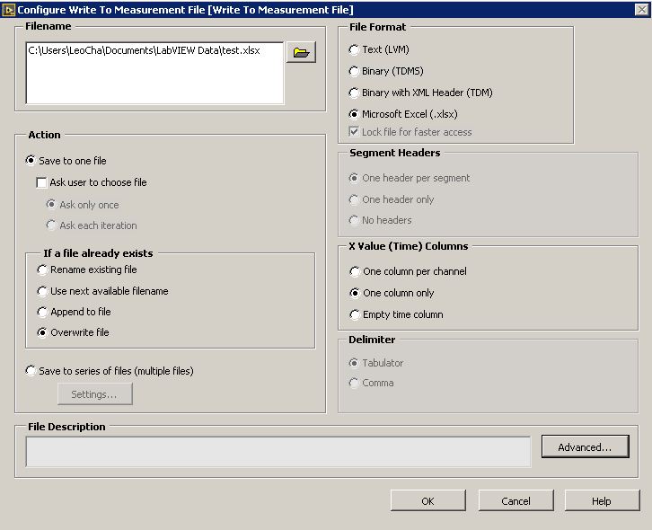

You are using Write to Measurement File, which "hides" from you a lot of details (but requires no thinking on your part).  In this case, it is writing a TimeStamp in Cell A2 and either writing 0 or probably not writing anything in the remaining cells in Column A.  A TimeStamp whose value is 0 is 1/1/1904, 00:00:00.
Bob Schor
