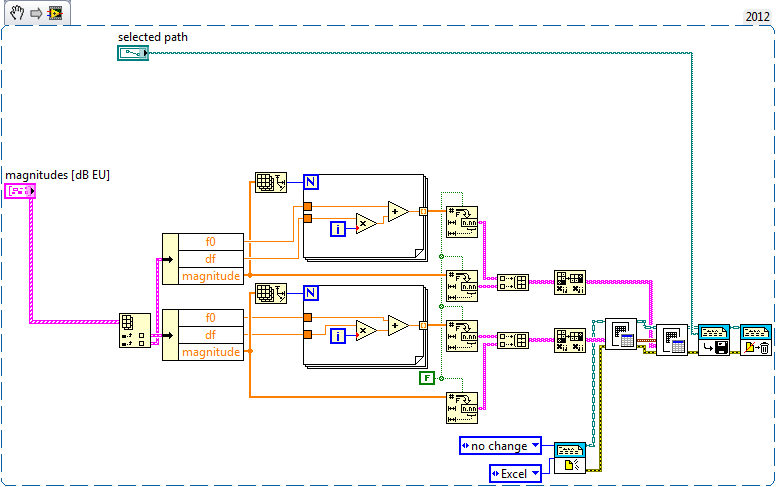

Hey Jean, Thanks again for helping out. I am trying to implement you solution but dont know what 1 block is, I see the following:
build array, transpose 2D array, excel easy text, excel easy table, save report, dispose report, new report. The block I can't figure out is before the build array block.
***Edit***
I'm assuming also that the 0 and 1 clusters are in the "start" input correct?
Message 11 of 24
(3,194 Views)
yes, that's right, they give the start coordinates for the write process
the ones you don't recognize are number to fractional string (strings-> numeric to string palette in lv2012)

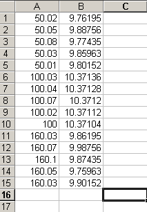

More details on want I'm looking for is for the magnitude to be next to it's corresponding frequency. The frequency is an input and the magnitude is the output. For example:
100Hz | 7.9542 mV
160Hz | 8.6324mV
But with this starting point I might need to redo certain portion of the code maybe, have a good weekend everyone 😃

oh, I see now, what you want
you need to create the frequency array based on f0 and df (take the length of the magnitude array and use it in a for loop to add i*df to f0, so the first element will be f0, and then increase it with df)
in the excel easy tables I use the "top right" output of the first one and wire it to the start input of the other to have them aligned nex to each other

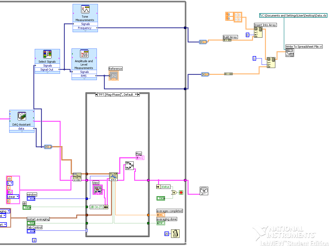

So I tried a couple of different ways using the setup we've been working with and just wasn't getting what I need.
I decided to go a different route but I am only getting the last output to save. there is just 1 frequency value in column 1 and 1 magnitude value in column 2. nothing else is saved. this VI is attached.
Attached is an example of what im looking for in excel that i made manually really quick.
